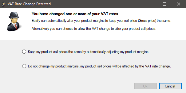

To get this behaviour you will need to change the value of a VAT rate twice.
- Open up Tools > VAT Settings
- While being VAT registered
- Change the standard VAT rate from 20 to 20.01 then click OK.
- Upon changing a VAT rate you will be prompted with the following options:
In your scenario, you want to keep your sell prices the same, so select the first option and click OK.
Keep my product sell prices the same by automatically adjusting my product margins.
- Now go back and change the standard VAT rate back to 20 and click OK and select the first option again.
This will make sure your product prices stay the same and the margins absorb the change in VAT rate.
Please note, if a product price needs to be reduced to the point the margin is lower than 0, you gross profit for that product will be negative.

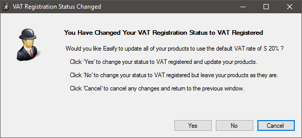

Thanks for the reply on this problem. I have done exactly as you said and it's still not working. It keeps adding 20% to the price that should already be gross. It is also not changing the net/vat on the buying in price.
When I change the VAT status to vat registered I am getting another pop-up window saying "you have changed your VAT registration status to VAT registered. Would you like Easify to update all of your products to use the default VAT rate of 20%. Click yes to change your status to VAT registered & update your products. Click no to change your status to VAT registered and leave your products as they are"
Whichever option I choose, it adds 20% the, already, gross price.

Apologies, this scenario isn't automated in Easify.
I have added a review item to our feature request list so we may review this functionality for a future update.
Turning on VAT registration will prompt whether or not you want to set the default VAT rate to each product. In 3.85 the standard / default VAT rate is 20%. Clicking no will leave your products at a 0% VAT rate.
