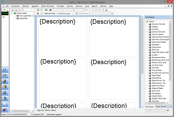

Yes it is possible to print four in one using the Label Designer, you just create a label that is A4 sized:
420 mm x 594 mm
Then just add the components that make up your labels, four times, one for each label.
Here's one I made earlier that repeats the product description six times.
