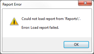

This article helps you solve the following error message:
"Report Error. Could not load report from 'Reports\'. Error: Load report failed."
